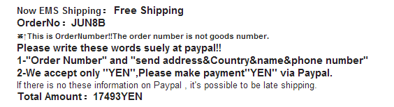

44tim44
Posts: 51
Joined: 9 May 2014, 17:14
Location: Örebro
Re: Nybörjare med sniper-ambition
Postby 44tim44 » 9 June 2014, 11:23
Jajamän, från X-fire.
Free EMS shipping. :D
